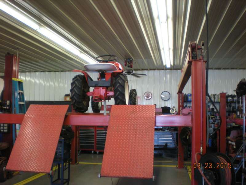

Wheel Horses of course! :woo
We worked on the cars most of the day. Mondays are for cars if an old car customer that we kept wants in, we did keep a few. Last week it turned into Monday - Thursday. That's gotta stop. :doh We do however have the rest of this week for the Horses.

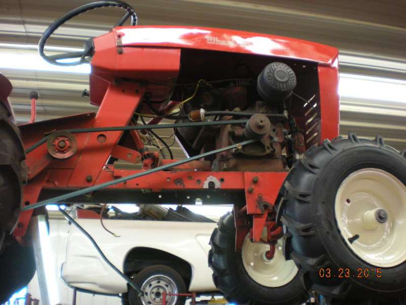

We're trying to get the 1045 ready for Sandra to use until we get her Lawn Ranger ready. The front step rod was broken loose and someone welded up a large mess. They welded it on the outside, then the pedal wouldn't go against the frame so everything ran crooked and the belt wouldn't stay on. Then the welds must have broken so they drilled more holes in the frame and made a plate to hold it up but it still moved all over the place.
I've got the rod welded back in and the extra holes welded up. Our trusty camera girl will have pics of it tomorrow. :smile2
