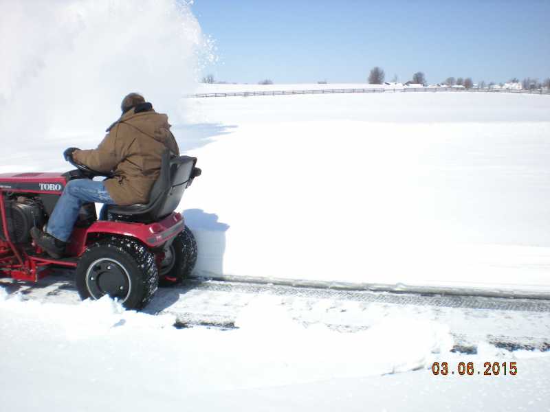

2 Stage Blower doing its thing.

That still amazes me. Nothing like a Horse.

Awesome....and to think I had one of these in my hands last fall.....
