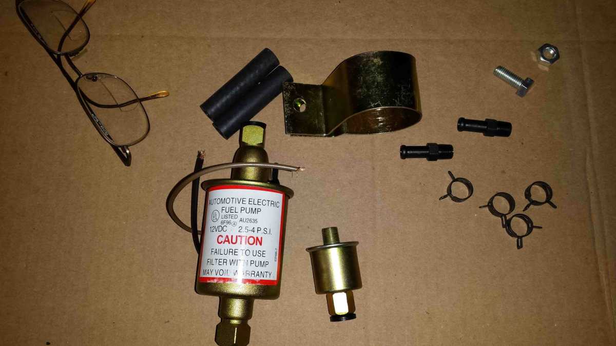

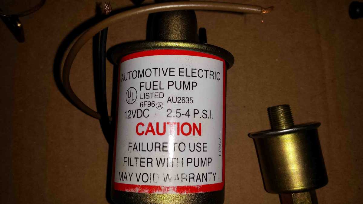

The D series has a vacuum pump that sometimes takes a while to get fuel to the engine after the tractor sits a while.. Always wanted to try an electric one....got one for a little over 15 bucks off ebay. They are bigger than I thought....kinda hard to find a good spot for them. Still have to wire it and add a new filter after the tank/before the pump. I did install a filter before the carb....a small one.

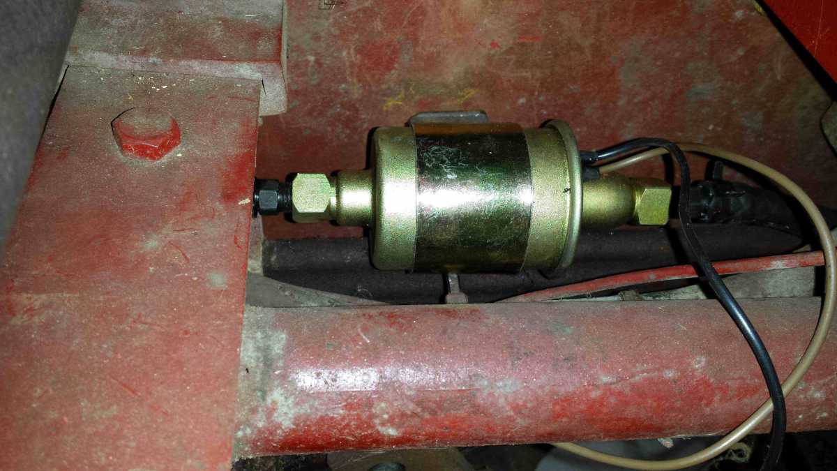

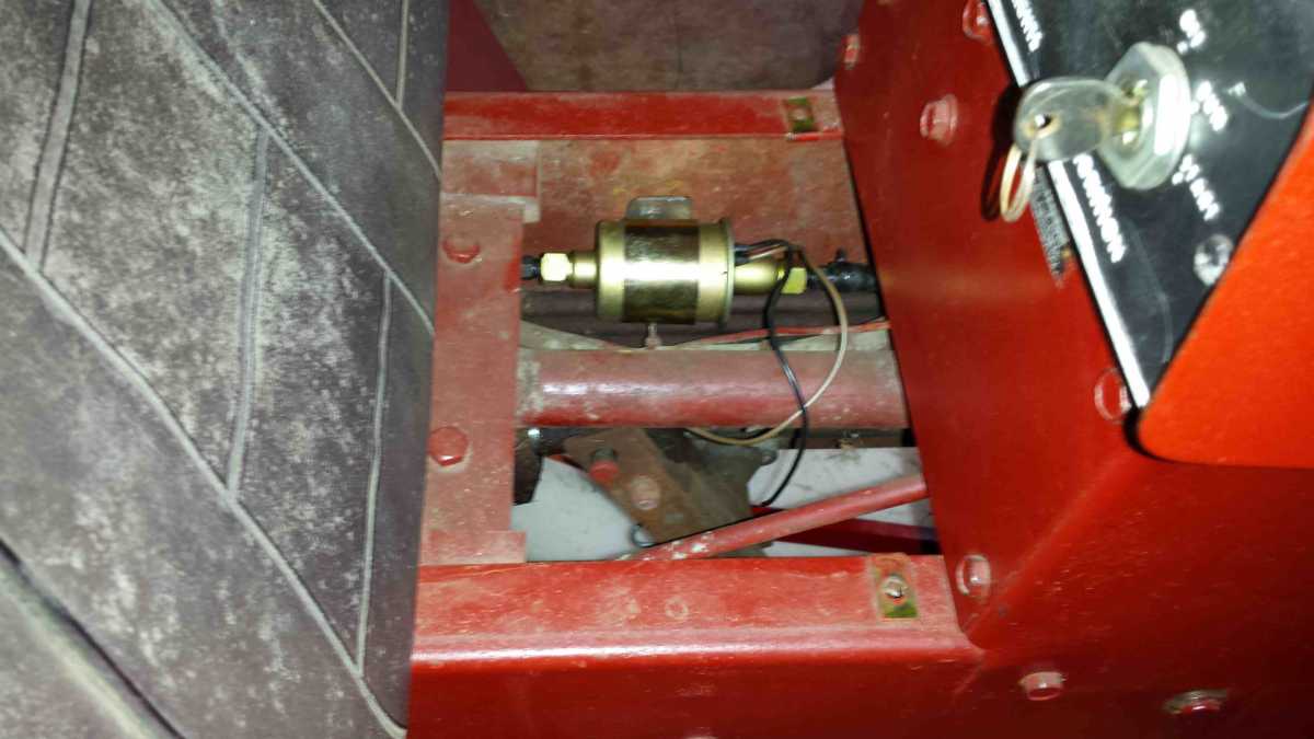

Replied by Geno on topic Electric Fuel Pump
Really nice job Bob, looks like the prefect spot too.

Replied by Kurt-NEPA on topic Electric Fuel Pump
Nice job Bob, I'm thinking of doing the same thing on my 520H's. The only thing stopping me is finding a good place to mount the pump.
Keep us posted on how this works out.
